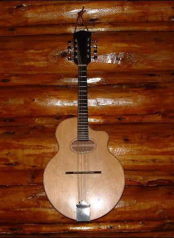

I started building Flat topped(domed) mandolins in the
Early 90's A-Models. My first Guitar shaped ones
came soon after. The first two I built where deep
sides at 2 1/4" 1-maple and 1-mahogony.
Both where bass dominate. Here's a picture of a
proto-type I hope to offer in 07, still a touch bass
heavy, but louder than a carved top. 1 11/16" sides.
Good luck with your build. It is looking great.
I would love if you could share details.(size,scale).
Tom

As for the Mandonaught (I like the name.... I was thinking frigate, but mandonaught is better!!!) Scale length is whatever stewmac cut thier fingerboards at..... 12 3/4" or so I think....
the walnut was scrounged from a local shopfitter for free, the spruce top is half a AA classical top from SM. Neck will be another bit of the scrounged stuff..... Maybe oak? EIR fingerboard, tuners & tailpiece from SM, Bone bridge from Inlaidartist on Evilbay/
As for only starting recently, yes it's true, Since December I've thrown together a fretless bass, hollow acoustic Les Paul, two carved pine topped mandos (one now in Sam's hands) a guitar shaped mando, a resonator and now I'm waiting for the postman so I can finish the mandonaught.......
